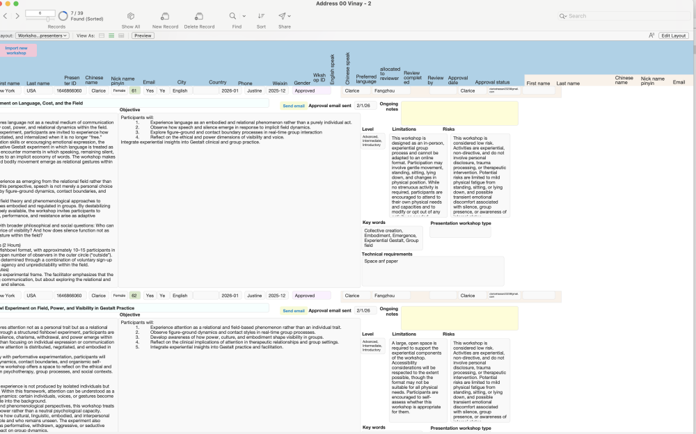

You can see here, as I scroll the row, the header stays fixed:

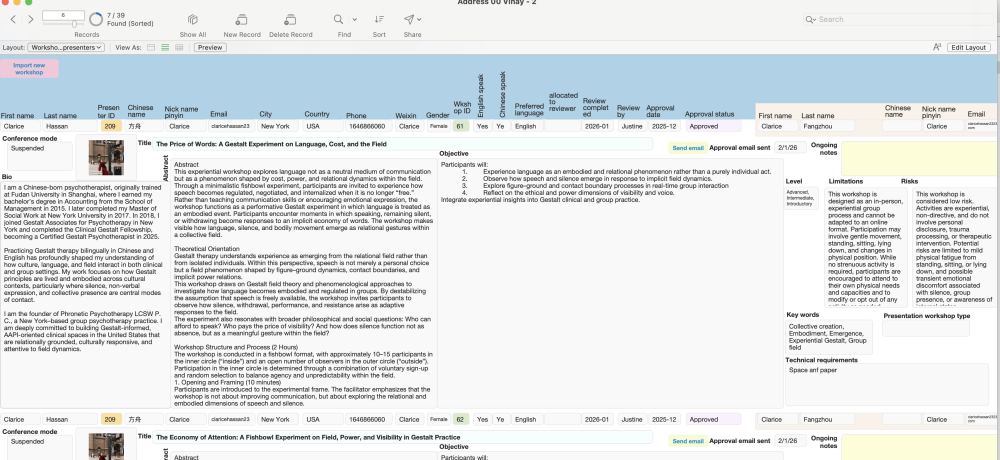

You haven't answered my question. Go into Layout mode and check the label of the blue part. Based on your description it will look like this:
or:
Double-click the "Top Navigation" label and change it to "Header".
  • Solution
Thanks so much. Thats it I never knew this before..or maybe its a newer feature. Support much appreciated.
