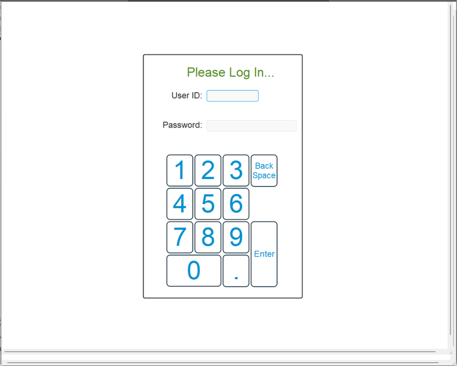

OK, so I got it "working", but when I have it run using a powershell script that has a Start-sleep timer in it, that just starts the same as a shortcut does, it opens with what appear to be TWO windows, like this below. Notice the scroll bars on the sides and bottom?
It does not do this when not in Kiosk mode...???

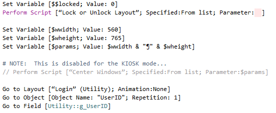

There are only two man layouts, "Login" and "InputScreen", both are exactly the same size, and "Login" is loaded at startup via a script in File Options / Script Triggers / OnFirstWindowOpen. The script is below. Note, the $wwidth and $wheight are not used with Kiosk mode, script for centering/resizing windows has been disabled with "exit script" at beginning.
