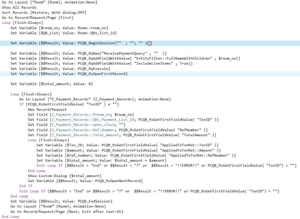

Retrieving invoices linked to a payment to check if the payment balance is zero
I am desperately trying to retrieving invoices linked to payments to check if the payment balance is zero in order to skip those specific payments when I then try to link new imported invoices into payments with balance <>0.
I use the scripts below but it does not return me the list of invoices applied to the single payments to check if the total equal the payment total amount. Where is the problem with the script?
Thank yo so much.

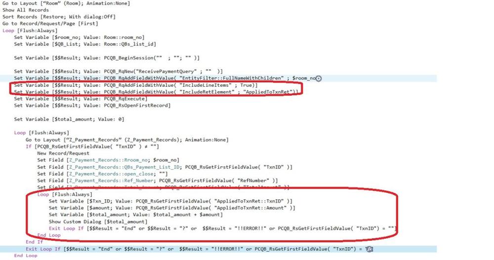

Dear Sir,
I changed like this but still not working
I tried again with this script but, if I include the two linen in red after the EXECUTE it will not return the "TxnID". If take them out it returns the "TxnID.

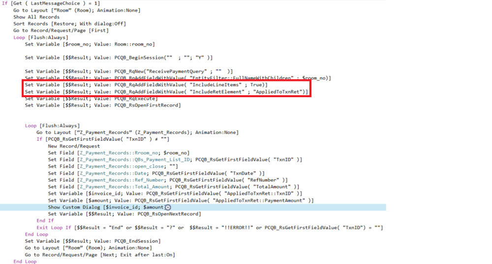

Dear All,
disregard this issue ticket. I solved the problem.
Thank you for your support.
