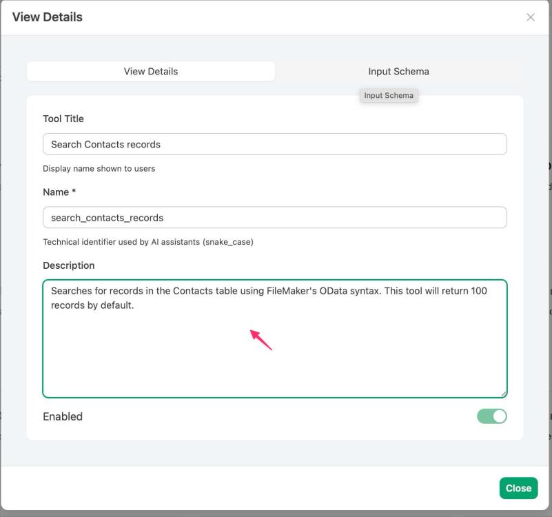

When I created a new context and then created a new connection, the app came up with these various defaults...
Your FileMaker account must have both the OData (fmodata) and Data API (fmrest) extended privilege sets enabled. The Data API is used internally for table and script discovery during setup.
Yes, I have both the both the OData (fmodata) and Data API (fmrest) set up for this file
Search Contacts records - description box
And as an example, it added this by itself...
Searches Contacts records using FileMaker OData syntax (100 records default).
Q: - are you telling me that somehow I could switch this over to use data API instead?
And if so, I imagine I would have to include a layout in this description so how would I update this?
Thanks in advance for your help

Hi Alex,
Thanks So much for your excellent help!
In my case, these are the default settings when you create a new connection. And as you can see everything says odata...
So my question is if I was going to try to convert this over to data api - how could I do that?
The description box says this
Searches for records in the Contacts table using FileMaker's OData syntax. This tool will return 100 records by default.
Could I switch it over somehow and say this?
Searches for records in the Contacts table using FileMaker's Data API syntax. This tool will return 100 records by default.
And then how would I tell it to use a specific layout?
Search for records using layout "MySimpleLayout"

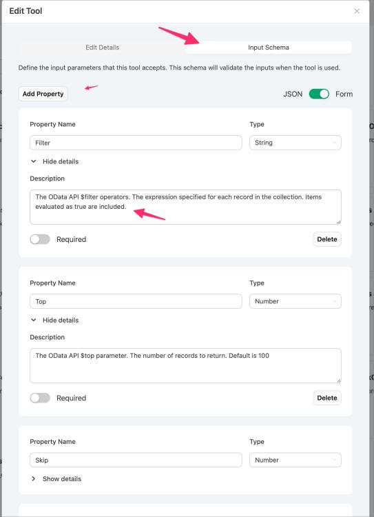

And then, at the same time we have the input schema
And as you can see, it is currently set to odata...
The OData API $filter operators. The expression specified for each record in the collection. Items evaluated as true are included.
Anyway, this is all quite interesting.
And if I had to use odata for searching, and I wanted to eliminate container fields - would I just tell it the Fields I wanted it to return?
Returned only these fields - Firstname, Lastname, Company, Phone .... something like that?
