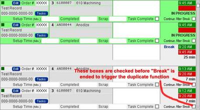

Scenario: Running a script that automatically duplicates portal records in a loop, based off whether a field "Continue After Break" is checked.
The solution is a "Time Tracking" DB that allows employees to log their times against certain orders and jobs. I am trying to implement a quick, one button way to log in and out of break, and automatically starting on the job the person was working on before break.
Problem: After the script is run, it appears as if all the portals did not get updated with the new information. Selecting the entire portal row "refreshes" that row to what is really there, but I think it should just automatically update. Puting a Refresh command in my script does nothing for this problem.
I suspect the problem may be related to the fact that I have two calculation-container fields using different colors and covering up unneeded information (see attachment). But I'm not sure. Any ideas? I will elaborate upon request, including posting the entire script.
