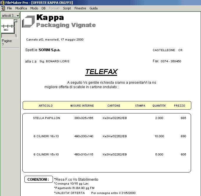

look here, I tried with the generic text printer, but I didn't get what I thought...
that's the original file:
and here there is the printed file
filemaker.txt
It is for printing scripts! Not layouts etc, unless you need some TXT file produced, which can be sometimes useful...
