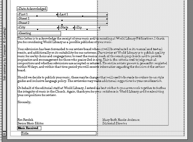

Now I switch to a letter layout.
The Address field is in the header (along with the form letter stuff.)
The ItemName field is in the body.

In FileMaker terms, what you are trying to achieve is described as a sub-summary - ie you want the various items found in DB C to be separated into groups according to the associated address, then printed out with the address above them.
To achieve that, you should go into layout mode and double click on the tab which labels the 'header' part. That will bring up the parts dialog box. In the parts dialog, change the header to a leading sub-summary part to appear when the found set is sorted by the AddressID field.
Once you've done that, return to browse mode, sort the database by the address field, then go have a look at it in Preview mode. I believe that what you see will then be a lot closer to what you're looking for. wink.gif

I changed the header to a leading sub-summary by the addressID field. I left the Items in the body.

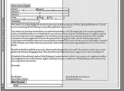

I know what's happening. In layout mode, there is this dotted line and a grayed out section which places the next record in another column. That line was moved off the edge of the page, so that the other records were not visible.
I moved the dotted line to the middle of the page and saw the other records.
I would like to have the dotted line in the body so that the Items field can go in two columns, but the other stuff (address and form letter) in the sub-summary to be one record for each page.

Hi Keith,
By default, layout columns in FileMaker are applied only to the body part, so the header, sub-summary and footer (if any) should not be affected.
To get the output to group contents appropriately, double-click on the sub-summary part flag and select the option for 'Page break before each occurrence' which appears in the lower part of the dialog. With that in place, when you preview or print (with the database appropriately sorted) each sub-summary should start a new page and should be followed by the columnized body part listing all the items which relate to the sub-summary.

I got it! In the layout setup I changed the print in 2 columns to across instead of down.
