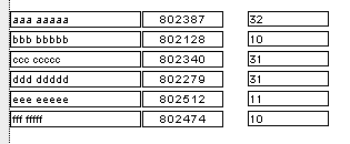

I have an attendance database and attendance is recorded in the field "AttendanceStatus". Three values are allowed as input to this field: Present; Absent; and Homestay. I would like to be able to display the total count of presence and absence for a given month for a given student, but every attempt i have made results in either the averages or the totals for every student in the found set.
I have one field (cPresence) checking for the text "Present" in the field AttendanceStatus and returning a "1" if it finds that text. My summary field (sPresentCnt) is a 'count' of (cPresence). Anyway, its an un working mess at the moment and i need to find some instructional material that will help me figure out how to best create summary reports in all sorts of circumstances.

Ok, i have implemented your suggested solution and am one step further to my goal. The problem i have now run into is the numbers that i am given. For instance, "32" for student 'aaa aaaaa' is not the correct summation of the number of times the student was present. Interestingly, i have created two calculation fields that record the total number of averages for the given found set. One field returns a "1" if the field "attendancestatus" has 'absent' as its value (0 if anything else or nothing). The second calculation sums the first calc field for a given found set. It does this through a relationship (studentID=::studentID) so that it will only sum the absence_calc fields for a given student. This set of fields, dealing with absence, works correctly. The two fields for presence are set up exactly the same, however they do not produce correct results. For instance, the second presence calc field is set to sum the first presence calc field (just like the absence fields). In the current found set, the field cPresence for each record contained the number "0". The field "cPresentCnt" summed these 31 zeros as 17. Now, i have no idea where it is getting the number 17.

For student aaa (etc.) it's not showing 32 here... It's showing 17 total present...

I dunno. I do a simple Find for "aaa aaaaa" and "present" and I get 32. Find for "aaa aaaaa" and cPresent = 1, also 32. Maybe if you're finding a subset, by month or something, you're seeing different (Nov. is 16).
