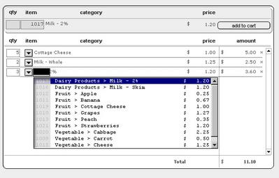

consider the next two approaches
1. semi tranparent "cover" for those that "Number-Inclined" for fast(er) entry
2. totaly "covered" for those that like to "Read"
I will attach them in 2 posts so I don't have to serve or zip these JPGs.
Let me know waht you thik!

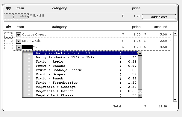

second:

that was just an image created by Photoshop with a few effects and vertical letter "o"....toggle on-off image conditionally was where I need(ed) help. In order for it to work I would have to find the way to controll the longht of the drop list....any thughts?
