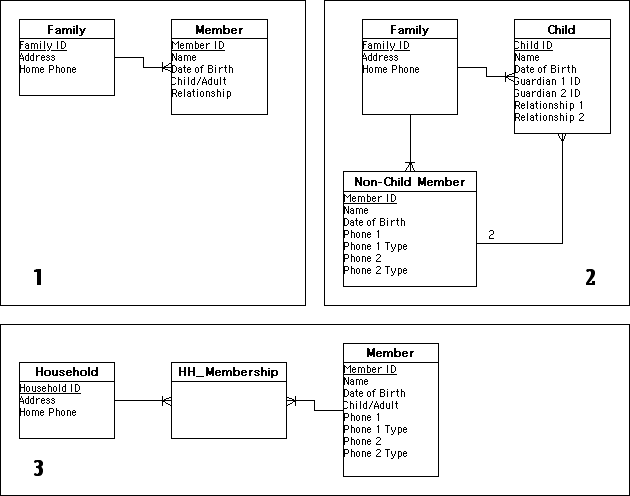

I do all my relationship thinking with ER diagrams, so here are a few possibilities.
To read the graphs, think of a single line entering an entity as a "one" and a chicken foot entering an entity as a "many". So in example 1, "one" family can have "many" members, but each member can only have "one" family. Underlined words are the identifiers for that entity, along with any entering chicken feet with a slash through it.
Thanks. In your diagram 3, do you intend this to model a data/interface separation model? i.e., is the blank box in the middle an interface file with no fields/data, or is this some other relational feature that I haven't run into yet? (Or just an incomplete diagram?) As you can tell, I'm coming from a "flat" background and just learning the relational way of doing things.

Good questions.
The HH_Membership entity in example 3 is a back-end table. You would access it through portals in one of the other two files. The fields it would have are the identifiers it depends on (Member ID from Member and Household ID from Household), plus some lookups from other related files that make the interface work. The fields aren't specified because the IDs are implied from the dependencies on the chicken feet, and the lookups are not where the data originates.
Examples for HH_Membership fields if the portal to HH_Membership is in the Household table:
Household ID
Member ID
Member Name
Member Date of Birth
Member Type
Member Phone 1
So in example 3, the household data is populated in a layout in Household, the member data is populated in a layout in Member, and the members are picked for each household after words, through a portal in Household. As you can see the data entry is more work in this model.

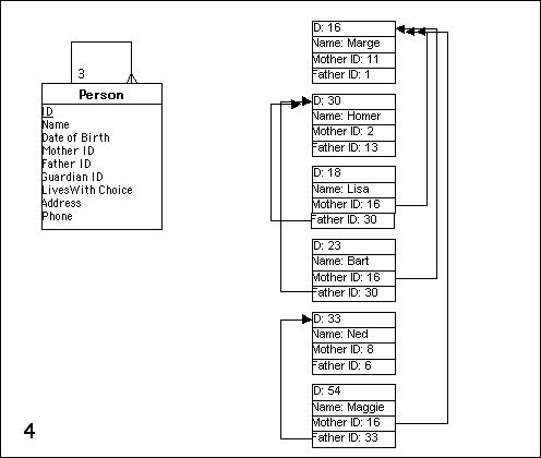

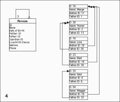

I dreamt up another interesting Family solution involving one table with three self-join relationships. This is sort of a family tree model. Each person can have a Mother, Father and a Guardian. The address would then be a lookup based on the LivesWithChoice. Each person, in turn can have children that are Persons under them in the tree.
The difficulty with this model is that there is no Family entity which ties all the Persons together. They are only related by who has the same Mother and Father IDs and who is directly above and below them in the tree.
