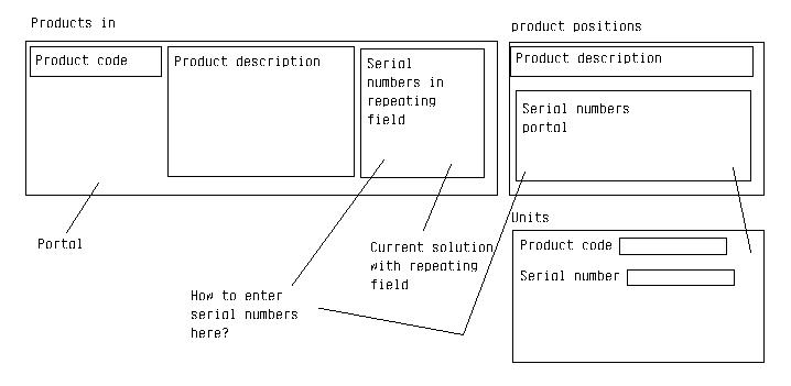

I now have database products_in (this holds portal (from database product_positions) with products that firm ordered). Product_positions have portal with product serial numbers (database units_in). Everything works fine, but they want to enter data in first database products_in with their serial numbers also.
Is there a solution to this problem?
I attached simple shema of situation.
Please help me guys...
Dean
So you can enter data into the "Product code" and "Product description" fields, but not "Serial numbers in repeating field?" Check that the repeating field is a related field (has the :: before the name of the field in layout mode).
J
Yes I can enter data in repeating field but i want to get rid of it.
Repeating field has only few rows but what if I need to put 100 serial numbers in it?
The issue is that they want enter product serial numbers with order layout (layout on which is portal with ordered products).
Dean
OK, so you want to make the repeating field into a non-rep. field but shown through a portal. (Stop me if i'm mistaken.) You can't put a portal within a portal, so what you must do is direct the user to a layout (can be done with a simple button) that shows Product Code and Product Description as non-related fields, with SerialNumber fields in another portal. So you will have to be in the file where Products are the top level in order to enter serial numbers.
