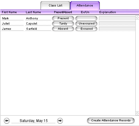

For the data entry, you will have an attendance portal showing all current students for the current room and specified date. The current room is likely to be a ClassID field in your Class file. The specified date can be a global field in that file. You can put these together in a concatenated key, ClassID_AttendDate. This will be the key for the portal relationship. In the Attendance file you will create a foreign key, ClassID_Date. (If you plan on making multiple years's attendance records available, you would need School Year to be part of the key too. I recommend archiving past year's attendance records, just to keep the file size down.)
I think it's best if the attendance portal is already populated when teachers pull up the screen, so if a teacher forgets to mark attendance records, it is easy to find the ones not completed in a report. To populate the Attendance database, I recommend (each day) running an import script of all currently enrolled students.
If you need aggregate numbers for each day, just run summary reports in the Attendance file.
I recommend an interface that allows teachers to go back to previous days to fix attendance records, or mark ones they forgot. Below is an interface for one attendance system I did that shows this.

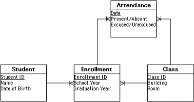

I'm really surprised by how accepting those in this thread are to storing a record for every student who is NOT absent from or late for class. Why? Does your local police department store records noting the citizens who do NOT rob their local convenience store? The fact that a record is NOT in a database is informative in itself. Sorry for the caps, its just rather startling.
I suspect though, that the reason for storing so many non-event records is that its easier from a relationship/portal perspective. Having to create an attendance record when the teacher selects absent on the portal row is bothersome. Not to mention deleting it when he realizes the student is just off in the washroom. Plus there is a second relationship to consider in picking out the attendance records while already inside a portal for the class/student relationship (for ver6). Its not a trivial problem. But its worthwhile pursuing a solution to it. If not to keep the database cleaner and make searching and sorting much quicker or to follow the guideline of keeping the database structure simple and putting the logic in the business layer (read script) then just because its an interesting problem. And that's why I seem to spend so much time mucking around in FileMaker. The bleeding obvious sometimes is very non-trivial.
I've worked with private schools for the past 10 years and come across a number of school admin packages as well worked for a company that markets one in FoxPro. None of those record the fact that a student is present. Its assumed. I've also developed an online school attendance solution in C# on Sql-Server. It never occured to me to store all those records.
To put credence to my rant, I spent some time today roughing out an example student/attendance DB in FMP6. Attached is the zip file. Please have a look. I'd be happy to have you find something useful in there and wish to use it in your project.

Dan,
Unless there are compelling reasons to do so, I would not separate different grades or classrooms into different tables. Much easier to fix a bug or add a report to one table rather one for each grade. Much easier to show a student's history when it is all together in one table.
To me it makes more sense to have Grade as a function of Graduation Year and School Year. Classroom should be a simple text field.

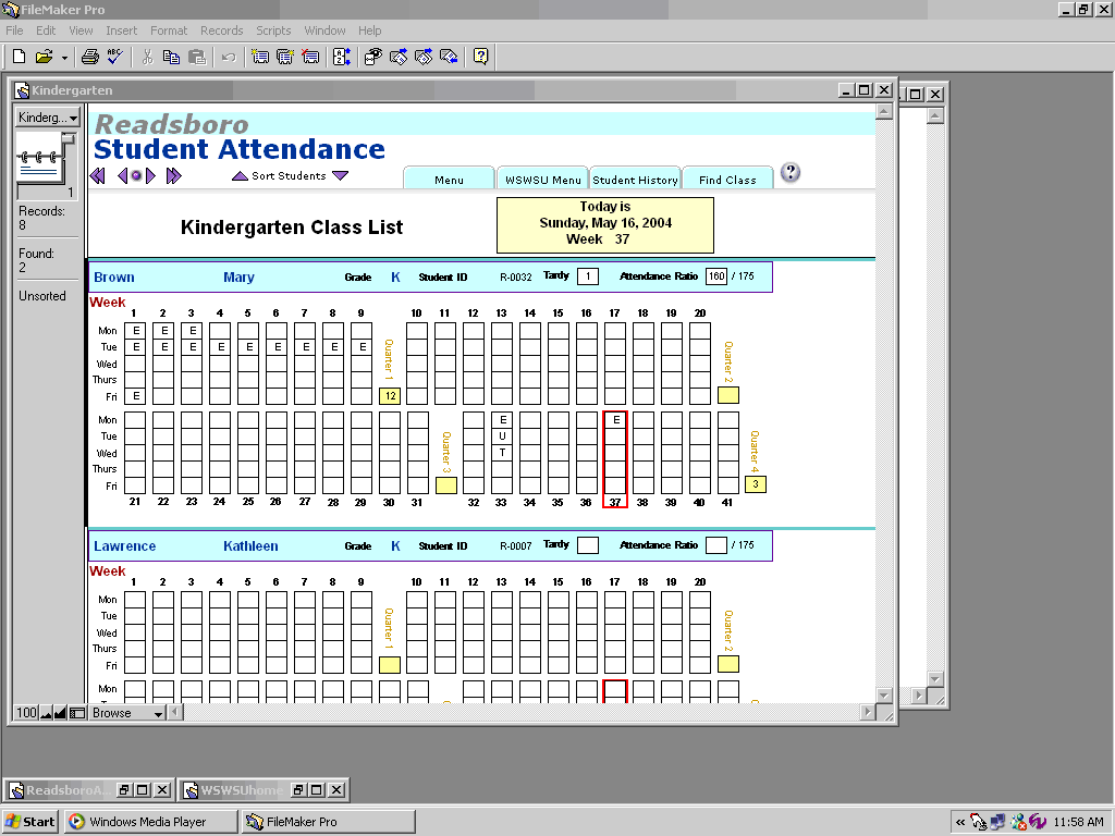

Hi all:
If you look at a teacher's attendance book, the format tends to be a check-mark for "present" and a blank space for "absent." This is logical. It is also logical to have an attendance record for every student for every class-instance, because a class-instance may have more, relationally, than just a record of if they were there or not. Was it a sex-ed day? Was it the day of the class photo? Was it the day the idiotic recruiter from the Army turned up? Was there a quiz? A test? A "yes" or "no" (and/or a grade) is easier to deal with than the process of finding missing records from the found set (in the sense that if a student wasn't present, there's no record, or vice-versa)...
Anyway, these are fairly short records, and you can fit (literally) millions of them on a modern hard drive before you begin to run out of space. How many student-class-instances do you have? You've got to remember that you're (generally) dealing with gigabytes nowadays on a hard-drive, and that's a lot of space.

Ender,
The reports you mention are of course always necessary and the packages I've dealt with did include them. I've written some in Crystal Reports. The advantage those systems have in using SQL for data access is the ability to do outer joins between tables. SQL can retrieve records from one table along with any matching records from a second table. If there is no matching record, that fact can be returned by providing empty fields.
Determining how many absents a student has in a given time period is equivalent to counting the number of absent records. The number of present days is some calculation involving this and the number of school days in the period. One table those packages do have is a calendar. That contains one record for each day in the school year with a field for type of day (school, weekend, holiday, etc). This can provide a count of school days over a time period.
As for FileMaker, you'll note the field 'AttendanceDaily' in Student.fp5 does return the value 'Present' when there is no record in Attendance.fp5 for the date in question. This value for the attendance code is represented by the absence of a record. So in a sense the database already stores this information. Explicitly storing it is redundant. The issue, as you point out, is how to exploit this fact in FileMaker. I'll spend some time on this and see what comes up.
There is another approach to consider for the reports you mention. Take them out of FileMaker and do them in Crystal Reports or some Mac equivalent. That is if the only reason you store so many records is to create the reports.

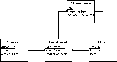

Stanley,
Your comparison with the teacher's attendance book is fine for the layout the teacher uses to enter/display the data. This affects but doesn't determine the internal organization of the data. At least this is true in a multi-tier application. In FileMaker the layout is usually pretty much the database so I can understand why you'd organize it like the paper equivalent.
The fact that a particular day was Army recruiter day is information relevant to the day and perhaps class, storing this in every student's class/student/day record is redundant. Firstly, relational database design is hugely about minimizing redundancy and secondly this approach trades off design time effort for the ongoing effort of ensuring all those extra records get put in the right place before they're needed and stay there over time. I'm all for doing the work up front and keeping the maintenance simple.

Fenton,
Its a good suggestion using a script to build intermediate data for the report. Build the totals into a separate database, produce the report then throw the data away. By rebuilding the report data each time you give the user more control over the parameters for the report. Also, you don't dump responsibility for producing the data on some other process or worse, a user.
Following this idea, I've attached a zip which includes an aggregate report which shows attendance for a class over a given period of time. Ender, this may provide the structure for your %present classroom report. The script for this report first clears accumulator fields in the student record, then transfers to the attendance table to loop through the relevant records accumulating into the student table fields. The report itself is just a list of student records with summary fields added in the footer (though it could be done as a class/student portal). This implementation obviously only tolerates one user at a time.
Your second report, Ender, listing a student's attendance history, could be accomplished with the calendar table I mentioned previously. The report needs a record for every date in the requested range. Currently this requirement is satisfied by storing these records for each student or worse, each student/class. I content its only necessary to store these once. The report can be produced in the calendar table with the 'AttendanceDaily' field and relationship copied over from the student table. Though using a global for the StudentID and the date from the calendar record for the relationship to the attendance table. Do you think this would satisfy your attendance history report?
Fenton, I'm not too clear on your second paragraph. Consider that the teacher is looking at the layout you present to them. They are not looking at your database field structure. This idea of separating the user interface from the data structure has been around a long time but not, it seems, in the FileMaker world. Likely because a layout field, with the exception of a merge field, is a database field. I think a separate thread discussing ways of using multi-tier methods in FileMaker would be useful. And why they are a benefit, of course.
The case of when a student leaves a class in mid term as far as attendance is concerned can be handled by first storing a record somewhere to indicate the event has occurred. Then at data entry time, by checking for a record of withdrawal before deciding whether to display the student in the portal. At report time there is no change to the logic as there would be no further attendance records added after the withdrawal date. Any added prior would be included in reports if they fit into the report's date range. If the student withdraws before the cutoff date for the course, you would delete the entry and all relevant attendance records at withdrawal time and continue on as if he never existed ... and so on ... its a matter of following through all the event scenarios and applying the target site's rules to each.

About my second paragraph. I'm just saying that I don't know exactly what the teacher knows. Does he/she just glance at the classs, then enter a couple absences. Or do they do a real roll call? Do they do it on a laptop? Do they do it on a piece of paper?
I don't know which is better, create the multitude of records then post-process them, or build an interface to only create "absent" records, and a more complex report routine. I would tend toward the former, especially in version 7, which has such high limits.
