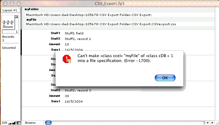

Thanks Fenton. I have adapted it to my DB and it seems to work fine although it does generate an error which I can't trace back. I checked with your sample file and got the same error (attached) on the wAS script.
David
Hmm? It works for me. But it sounds as if your version of AppleScript is not happy with setting the FileMaker field directly to a file specification; it was probably too hasty. So let's move that outside the FileMaker tell block. Try this, Perform AppleScript [
tell database 1
set theFile to cell "myFile"
end tell
tell application "Finder" -- needed inside FileMaker
set outputFile to theFile as file specification
set theText to read outputFile
set AppleScript's text item delimiters to {ASCII character 13}
set textList to text items of theText
set AppleScript's text item delimiters to {(ASCII character 13) & (ASCII character 10)}
set newText to (textList as text)
set AppleScript's text item delimiters to {""}
set eof of outputFile to 0
try
write newText to outputFile starting at eof
end try
end tell

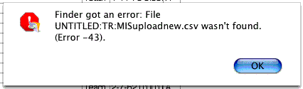

Thanks for the help Fenton. Again, this seems to create a perfectly usable .csv file called MISuploadnew.csv in the directory TR on my USB drive UNTITLED. It replaces the file if it already exists but generates the message in the attachment.
David
