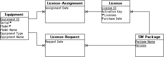

Welcome zarli!
It's not entirely clear what tables you currently have set up, so below is an ER Diagram showing a good possible structure for what you need. Each entity is a table, the lines represent the relationships. This does not transfer directly into the Table Occurence graph that FM7 uses, but it shows the basic idea. (Underlined words are keys, a chicken foot with a line implies additional key(s) linking the related table.)
To make this structure work properly, you would remove records from the License-Request table and add them to the License-Assignment table as you fill requests.
If you have a structure like this, it is then pretty straight-forward to show Total Assigned and Total Requested for each SW Package. A simple Count(License-Assignment::Equipment ID), and Count(License-Request::Equipment ID) in the SW Package table would do the trick.
>>How would you recomend the fields for these tables be set?
You would probably have data entry layouts for Equipment. On this you could have portals for Licenses Assigned and Licenses Requested. Using conditional value lists to enter available licenses and available SW Packages, respectively, might be the way to go.
To enter new Licenses, I would think a portal through SW Package would be easiest.
