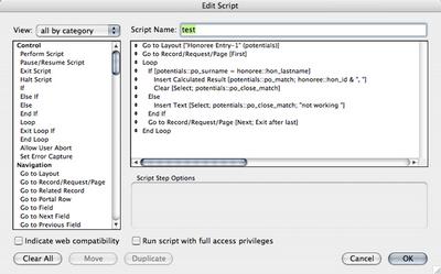

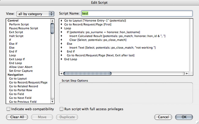

Compare two different fields from two tables
I'm trying to get file maker pro to compare two fields from two different tables to result in true/false. A screen shot of what I have is below. For some reason, I can't get the values in the honoree:hon_lastname to result in a true result when the potentials:po_surname is the exact same. Can anyone help?
1) Insert Calculated Result requires that the target field be present on the layout to paste successfully. If no field is active when the script is performed, the step has no effect. Does po_match exist on your Potentials Honoree_Entry1 layout?
2) What is your match field between Potentials and Honoree? Whenever I see Insert Calculated Result setting a field with 'ID' in it, I get suspicious of the relationship.
