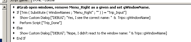

I think this should be easy but I must be missing something. I grab all open window names (knowing only 2 should be open), remove the name of one constant window and what's left should be the window I want to act on. That all works. I can return the resultant window name and it is correct.
I have tries then using 'Set Field' to poulate a global with the indow name so I can use it in a case or If...Then script. But while the global field shows it is being populated with the window name, the script won't act on it.
I have also tried passing the window name directly to the script, as in the attached screenshot, but that also fails. (The 'Else' clause always fires.)
What could I be doing wrong? The window name IS 'Trip_Input' and I can see it returned, so why do my scripts ignore it? Can anyone see?
Kurt
You've almost certainly got a carriage return at the end; which you can't see in the dialog. Trim only removes spaces. Substitute to remove

Thanks Fenton:
I DID have the wrong syntax and the added para-break was the issue.
