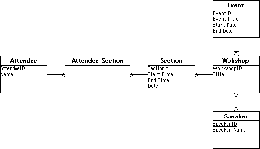

BTW: I know you have this system pretty much working for you, but you might find going to a normalized design helpful. If you had a structure similar to what I have below, you could keep data in there from year-to-year, and just add Events and their corresponding Workshops and Sections over time. The benefit is less data entry and the ability to quickly see the Attendee history over time. Something to think about.

Regarding your suggestion, that would work nicely if there weren't a magnitude of other varying factors. I only told you about the "Breakout Sessions" we're running on one day of a 4-day event. We do special events for a Fortune 50 company and rarely are 2 events ever remotely the same. Subsequently and because we do work for a number of different divisions, the attendees are rarely the same so while we could purge multiple attendee lists, it would serve little if no purpose to the client. (It's happened but it's rare.) Many times it's a "Customer" event to introduce a new product line or an appreciatory schmooze-job. I'm lucky if I get to import email addresses from a group of 15 previous client attendees. Client addresses commonly change with titles as they're moving up the ladder. By the same token, in the last 7 years, I've probably seen the same customer (maybe) twice. We literally manage everything from invitation distribution to hotel selection/management, flight schedules, ground transportation, who's staying for dinner and who wants cookies before bedtime. Basically we do it all (with the help of many various suppliers). The client just tells us who to invite and signs the check. wink.gif My objective is to get DB1 to the point that I can pass it off without the standard edits resulting from yet another customized event. I'm almost there if I get this and one other issue resolved.

Sounds like you have something quite similar to a classic edu course registration application where you have Student, Course, Section, Classroom, Teacher and you need to report student schedule, teacher schedule (and in edu, room schedule.) You may have seen this used before as the example for teaching about designing relationships.
Offhand, I think you're going to end up with a join file with one record for each attendee/session occurance.

I've seen this used as an example in teaching basic relational database design. Do you mean a sample database? Or the file/table design - tables/relationships?
Here's a tutorial using students, etc. to teach design/normalization: http://www.geekgirls.com/database_dictionary.htm
Scroll down to see the tables, fields, keys, etc. The Student/Courses table is the join I referred to earlier.
I also found a Filemaker 7 template, "Registration" that may provide some information. I downloaded it and was able to list attendees by event with event contact (substitute speaker). You could vary the layouts and get what you want. You could look at the relationships/tables they used to get a better idea.
