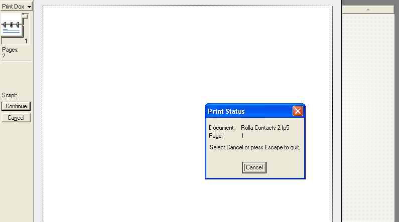

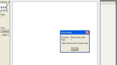

I recovered the DB's, and it hasn't happened again. I'm asking this, because I Haven't figured out how to prevent it. I've attached an image that shows the scroll bar that is causing the issue. I'm thinking this issue crashes the server, and corrupts the database.
When doing this printing loop, I use ProPrint Mega to change printers. Print a letter, change to envelope printer, print envelope, change back, and goto next client.
