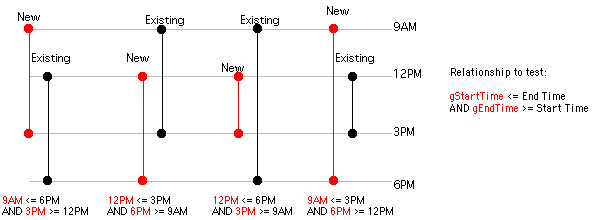

I think this relationship works correctly for range-to-range relationships:
gStartTime <= End Time
AND gEndTime >= Start Time
If we look at each possible overlap, it seems to cover all the possibilities. When there is no overlap, the relationship fails to match. Take a look at the attached diagram and see if there is an error in my thinking.
That's pretty slick... all along I'd been writing a single relationship for each possible conflict case rather than one catch-all. One thing though... if you use <= and >= won't it be seen as a conflict if the end time for a new reservation equals the the start time for an existing one or vice-versa? That usually wouldn't be considered a conflict. If you change the operators to < and >, then that is fixed but then the situation where start or end times are equal is not caught as a conflict.
I just don't know if it can all be done with one relationship. Unless you add gstart != end and gend !=start. Would that fix it all? My brain feels like mush this morning.....
