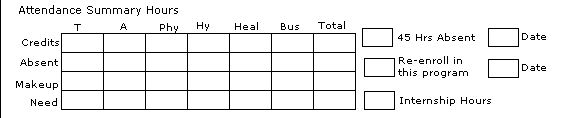

Basically I have attendance DB. This DB keep track of all the classes the student Attend. I want to get the total of credit hours for each class a student attended. I have two fields, one is call Class_id and the other is Class Number, each class already has assign how many credit hours it is. Also each student has its own StudentID and they are part of program so there is field for program call ProgramID.

The end result, i want to do is:
James has
T 35 Hrs
A 25 Hrs
H 15 Hrs
Now, I know how to do the whole total of credit hours for all the classes but not for the inviduals classes. I am running FM 6

This wont be a report. basically i want to give the person viewing the record of each students an overview of the student class attendance for each class.

maybe someone can help me with this part. i was able to break down the classes a student took, meaning i can tell how what is the total of T, A, P, H. A student took, now i need to figure out what is the total Hrs is for all the T, A, P, H. if anyone have idea let me know.
