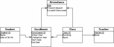

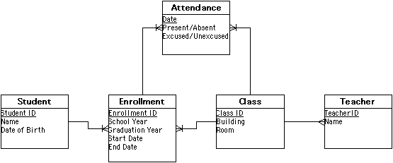

Okay Veronica,
Attached is an ERD (Entity-Relationship Diagram) for a typical Student-Enrollment system, where a class has more than one teacher and a teacher has only one class at a time.
Your table occurence graph will look a little different, as a TOG can't have a loop. But the diagram may help in the overall concept of how to relate the different entities.
It sounds like you're having trouble figuring out what relates to what in the relationships. First, remember that each table should have it's own primary key, which is usually an auto-entered serial number that is unique to each record. To link relationships between TOs, make sure you have a corresponding foreign key field set up in the table you're linking to. Foreign keys will be regular text or number fields (the same type as the primary key you're matching.) Example: relating Student to Enrollment requires the primary key 'Student ID' in Student to relate to the foreign key 'Student ID' in Enrollment (the ERD does not show foreign keys as these are implied.) With 'Allow creation of records through this relationship' set up, the foreign key will get populated automatically as you add rows to a portal with this relationship.
