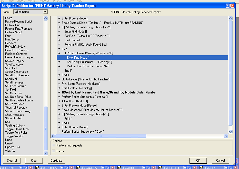

I'm certain it worked in my testing database but when I empty it all out and give it to the client it stops doing the find on me unless something else is wrong.
I wonder if maybe doing a sort after the find (which has constrain found set chosen) isn't mucking up my results.
well it seems that my issue has to do with trying to modularize my code. Once I take my 13 step script and add it directly the script that calls it stuff starts working again. how saddening :o
As Steve said in the other thread, it should be fine to modularize scripts. If you still want help with this, post the scripts that are not working so we can try to figure out why.
didn't see your response till i responded to steve, attached is a gif of the code window all the statbar sub-script does is open the stat bar so the user can hit continue in the preview window and i had modularized from the show custom dialog to the second end iff just before the go to layout call.
didn't see your response till i responded to steve...
