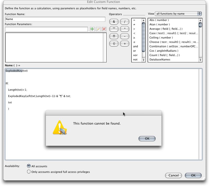

Dana
Sorry but ....
Replace Name with "ExplodedKey"
and write txt into the parameter cell off it, before entering the recursive function. It's a Hen & Egg issue...
This is not required in FMP7 see John Mark Osborne's Type Ahead demo on his site http://www.databasepros.com
It works
