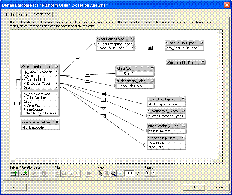

Thanks for all the great help. I have just one final request. If you go to HomePage > Select Query to View Counts > choose a Root Cause > press View Query; this will bring you to a portal with all the incidents that had the root cause chosen. Before I switched over to the portal method of storing root causes I had this function working. However, because the link OrderIncidents::k_incidentRootCause = Root Cause Types::kp_rootCauseCode is broken, this won't work anymore. I have instead the relationship OrderIncidents::kp_orderExceptionIndex = Root Cause Portal (same as APortal)B):Order Exception Index and Root Cause Portal::Root Cause Code = Root Cause Types::kp_RootCauseCode (see attached picture). Would you please help me with this query? How should I relate Relationship_Root Cause so that it actually looks at the root causes in each incidence? Thank you very much. You are the man!
Matthew Chan
I think I know the answer to your question, although you manage to hide it well in you post B) - the question you have is a tunneling question, which means that a value should be seen thru several relations. Which is possible by making another path with TO's from the same tables involved.
