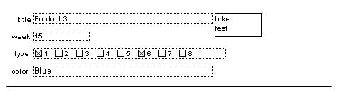

I added another relationship to your portal called "transport". I also added a field called transport in your product table. This relationship checks what values you added to your product. So when a company has transport method "bike" it will only show the products that match the transport method bike, leaving "green" for what it is...

go to your products table and add "feet" as a second value in the field "transport"

Actually you do relate product with transport:
Now I have to leave green products out of the portal if the company has the options 'bike'.
You related non green products with transport method "bike"
