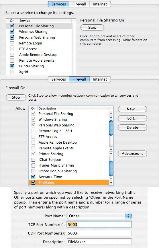

Apache should not be affected by port 5003. Could your Sharing settings be screwed up? Attached is a pic of my settings.
I know that Apache should not be affected but it seems it is. My sharing settings look very much the same as yours except for the UDP 5003 port that I cannot open unless I want Apache to be screwed up.
