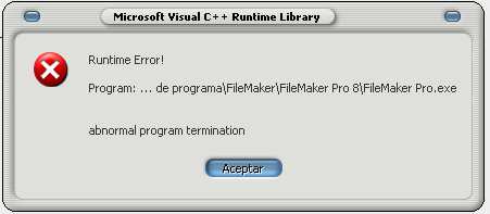

A few weeks ago I tried to run it over FM 8, everything works fine just for a small detail: I can't perform finds in date fields, when I try it gets a very strange error and then quits FM.

So I ended with a file (36k) containing a single field with no relation nor fields, file references or scritpt.
And the problem persists: I cant perform a find in that field.
