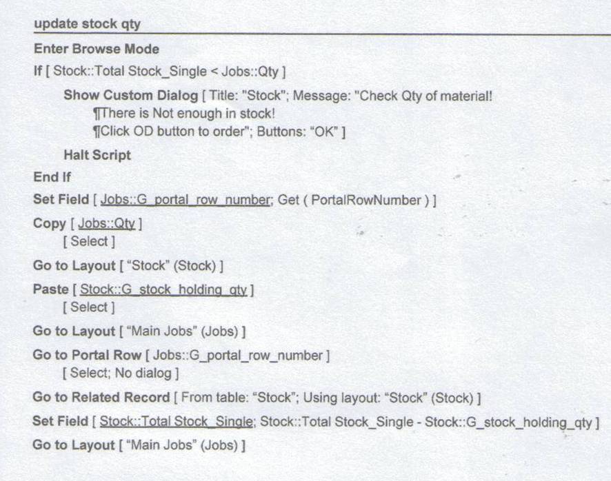

I have attached a scan of my script. Basically it takes stock from my tock table, based upon the qty of a order.
The problem is, I have to press it twice for the script to work. Is it because of the halt script step?
If so, any ideas on how to overcome?
also flashing occurs with this script.I have tried freezing window etc
I have managed to work it out. The "go to portal row" step was causing the prob.
Also, my global field was'nt global.
