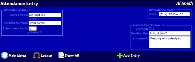

Here's my dilemma. I'm working on a school info. DB and I'm working on the attendance section of it. There are 2 methods for data entry.
  • Barcode scan sheets. -Secretary scans sheet containing barcodes for CourseCode and Student Number. He/She must then enter the attendance code either manually or by scanning a reference card containing the attendance codes.
  • Manual entry -Secretary selects full student name (LastName, FirstName) from a value list and then enters the attendance code.
My problem is caused by the latter or the 2 methods. Right now, with the automatic method - once the student number is scanned/entered, the FirstName and LastName fields do a lookup in the StudentInformation table for the apropriate values. The name is then displayed in the upper-right hand corner.
When the name is selected manually from the list, I need the student number to be automatically looked up and entered into the StudentNumber field in the Attendance table.
I've attached a copy of what the entry screen currently looks like for reference.
Thanks kindly.
