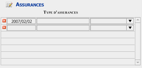

I have a problem when I hit tab after the last field in the record of any portal, it would bring me to the next line and creates an empty record when I leave. I also have a button that uses the Delete current record in the portal (each line has a button). The button does not remove the record. I end up always seeing an empty record with the del button that doesn't del the empty record.
I've attached a picture of it, as soon as I enter the date for the first line, the 2nd appears and never goes away.
This is a normal feature, It does not create an empty record, a new record will be created once you type info into the last portal row. Think of it as a place holder.
But man it looks ugly indeed, I script such matters by an extra relation with the option turned on, but the stuff shown in the portal is not set to "allow creation of rela..."

This uglyness has it's cures download this template to investigate some alternatives:
http://www.filemakerpros.com/NEWROW.zip
