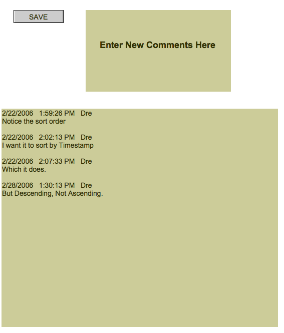

Here's my issue: I have created a Comments table, related to Jobs, and would like to display all related comment records in a large concatenated text field. It will allow user to view entire comment and timestamp vs using a portal (since length of comment is unknown).
However, I would like to sort descending, based on the timestamp, so the most current comment is always at the top of the list.
What I have so far seems to function, but I cannot figure out how to reverse sort the value list. Any help would be appreciated.

Define a calculation field cNegTime (in Comments table, result is Number) =
- Timestamp
Define your value list to also display values from cNegTime, and to sort by second field.
Thanks! It worked! Crazy how it can be the simplest idea that escapes your mind. I appreciate your help.
