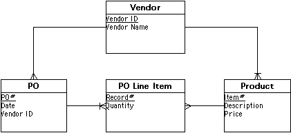

I noticed right away that you seem to be missing a line item table. You're using "Item 1", "Item 2", etc., which will give you problems down the road. Whenever you have a situation where you need to have several items of the same type (especially when the max number of these is unknown,) it is a good candidate for a related table.
Attached is an ER diagram showing a typical PO structure. Note that an ER diagram is not the same as FileMaker's relationship graph. The underlined field names are the primary keys. The foreign keys are implied by the relationship lines.
For FileMaker's relationship graph, you would need two occurences of one of the tables because a loop is not allowed. I would probably make two instances of the Vendor table, one related to PO by Vendor ID, and one related to Product by Vendor ID. To make the value list of products for the selected Vendor, you would then need an additional table occurence of Product off the Vendor by PO table occurence.

fmforums_ender.fp7.zip
Try pulling apart this.
PO.fp7.zip
Cool, makes sense now.
