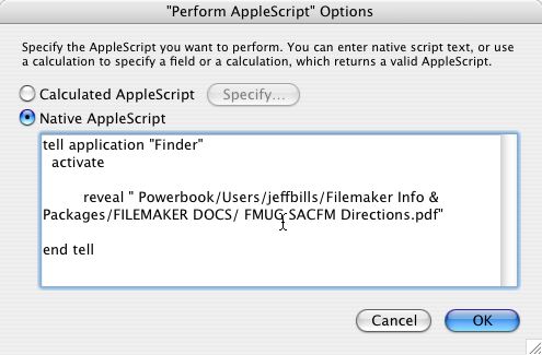

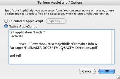

Hey all
Here's what I what i've done (see attachment)
I'm not getting it to work
Note that there is a space between the first quote and "Powerbook" . . . thus, " Powerbook"
That's just how I've named my hard drive so i can access it quickly from the desktop by pressing the space bar
Thanks!
I'm not very good with applescript, but I think the problem is that you can't use a posixpath (aka unix-style path, the ones with forward slashes) like that. See my example above which does it in two steps -- the first step converts the posix path to an alias to the file, and the second opens the alias.
