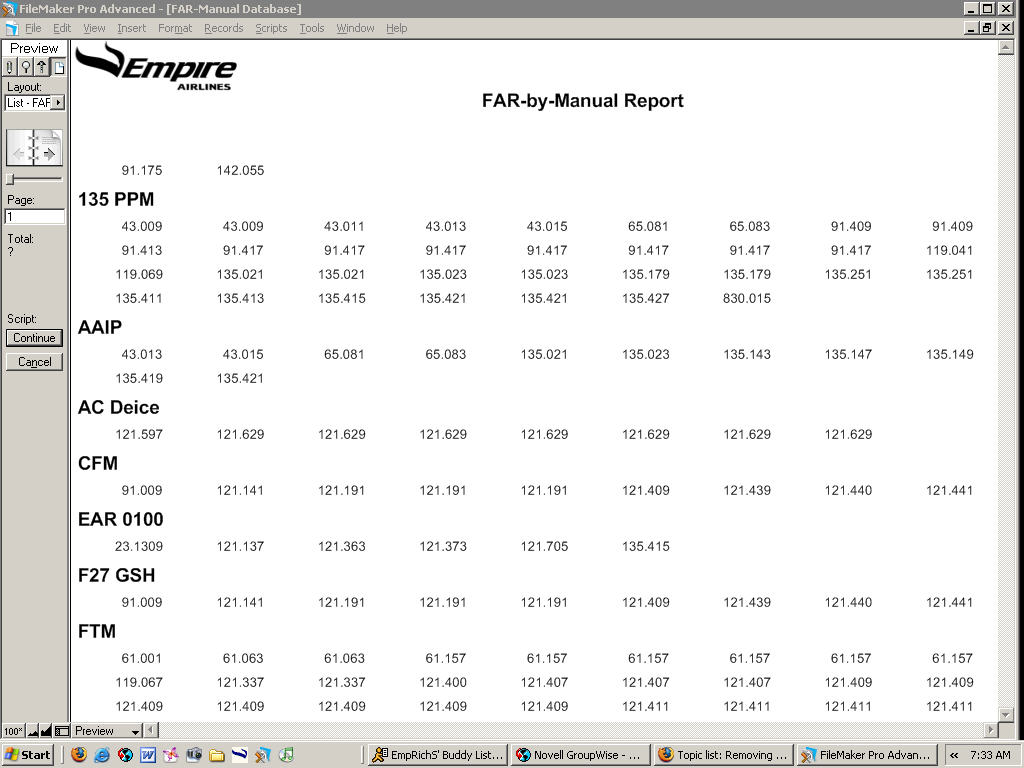

I'm overlooking something probably very obvious--no surprise there! Referring to the attached file, I want to prevent duplicate Federal Aviation Regulations (FAR) from appearing in the report--in the example attached, FAR 121.191. I thought of a sub-summary angle, but alas no success since it won't allow for column set-up in there. The nerve!

If you can forget about the columns, you are right about the report being very easy to create by adding another subsummary part. Subsummary parts can remove duplicates in a report. What you don't say is what the rest of the report will look like. For example, will there be additional Manual categories other than CRM (I am guessing yes)? If so, how many possible columns could you have in the report for any one Manual category? Will there be any totals or counts or just a listing of all the Manual categories followed by the Far_Decimalized values? Maybe you can create an example of the report in a spreadsheet, take a screen shot and attach it to this post so we can get a really good idea what you want.
The reason I ask all these questions is because it makes a difference on which solution I offer you. Basically, you are asking to create a cross-tab report which FileMaker is not very good at doing. There are many solutions out there so any help you can provide in outlining the details of how your report will look will really help in the quality of the answer.

Attached is a .jpg of what the report should look like. As you can see, the FARs will increment from left to right...though if it'll make things easier they can be listed top-down.

It will make things quite a bit easier if you list your FARs vertically rather than in columns. Then, all you have to do is change your Body part into a Subsummary when sorted by Far_Decimalized.
However, since you don't have any summary fields, you could easily eliminate duplicates from your found set using a looping script. This would allow you to keep the report in it's current configuration. Here's the script:
