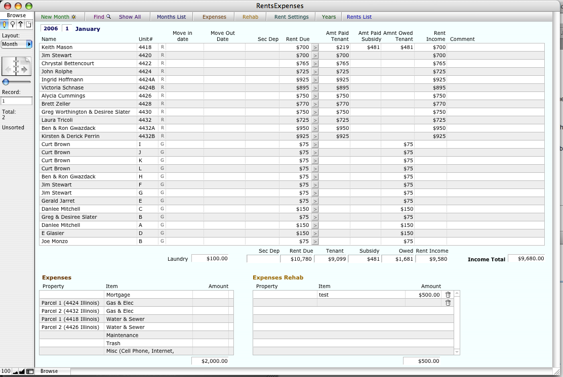

A further refinement (which I did for someone). Your most stable data entity is the property(s) and apartments, the Units. You could put the current tenant's ID into the Unit (simplest).
Since you expect to at least try and get the rent for each unit each month, what I did was import the Unit IDs (along with the current tenant) into a Rental_Payments table each month. That way they're all ready to go, with the expected rent looked up from a Rental_Rates table.
The advantage of pre-creating the monthly payment records is that it allows you to see not only what the expected rent is, but also see the gaps, who has not paid. It also serves as history of both.
Another simple table, with a record for each Year_Month, lets you view and enter data for the above. It also serves as a central point, so that another "monthy expenses" can be entered for the units.

I like both the entity focus change and the pre loading data concept. I have done a lot of real estate centered things, but most were centred around sales or construction as opposed to property management. In these cases the total property and the purchaser become most important. Here I can see where building reporting would be prime.
