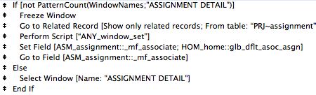

I have attached a screen shot of phase one and two of the script I am using. Can you take a quick peek and see if you see any apperent problems. THANKS!
screen_shot_phaseONE.pdf
screen_shot_phaseTWO.pdf
You didn't include the script "ANY_Window_Set". Since this script could run just prior to the Go to Field step, it might be the culprit.

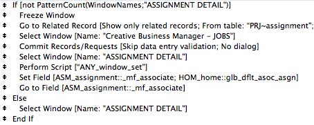

Randy and I emailed privately and he sent me a copy of his database. When I run his script normally, I can reproduce the problem. When I run the script with the debugger, it works perfectly. So, I threw some commit records, refresh windows and others steps to try and refresh whatever was causing the drop-down list not to work. Out of desperation, I tossed in a Pause/Resume Script step and paused for 1 second. This allowed the script to work but with a 1 second pause. Somehow, slowing down FileMaker and allowing it to catch up was the solution.
I investigated even more and finally discovered the problem diddn't occur if I changed one thing. I turned off the displaying of a new window when he uses the Go to Related Record step (from a selected portal row). This made it work perfectly. Since I am figuring Randy wants to display the related record in a new window, I devised a workaround to what seems to be a limitation or dare I say it... "bug".
Attached is his original script and the modified version of his script to which I added three new steps. Hope this helps someone. The basic idea was to use the Go to Related Record from the selected portal row to locate the related record in a new window. Then, the script selects the original window and commits the record. Finally, the script reselects the new window and uses the Go to Field step to select the drop-down list.
