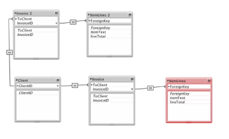

I have some troubles in following the description, because it's termed completely different in danish, however does it seem like the validation is an attempt to prevent selling more than the clients credit allow.
If it so can it be solved via the above RG, because if the itemline we work in via the portal is the one made red, could following native validation be instated:
Sum ( ItemLines 2::lineTotal ) < 30 and not IsEmpty ( Invoice::ToClient )
The idea is then to make one-line invoices with negative a negative sum for each payment, or make a ranecheck with several of the itemlines again with negative figures.
Try to read the calc' above it says - the sum of all itemlines issued to this client including the present in this invoice can't go higher than 29, further more do we need to ensure our self that we get every invoice issued previously to this client by checking if a customerID is present in the invoice.
The invoice Sum( is not yet made but should be in the Invoice...
