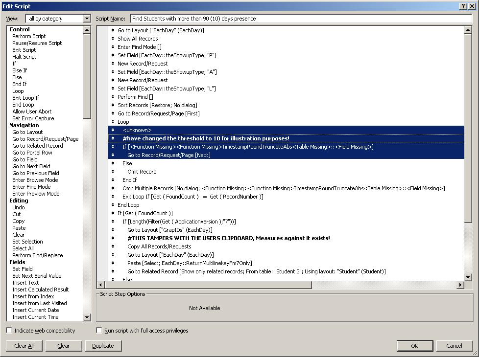

Hi.
I'm getting some script errors in the attached file. See attached showing missing functions?
Ah! I'm so sorry, I forgot when $variables were introduced!

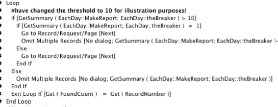

Checkout the attachment, and see the changes done above (...admitted, further consideration will give compacter code - given the limitation in commands availiable)

Found a quick optimization
