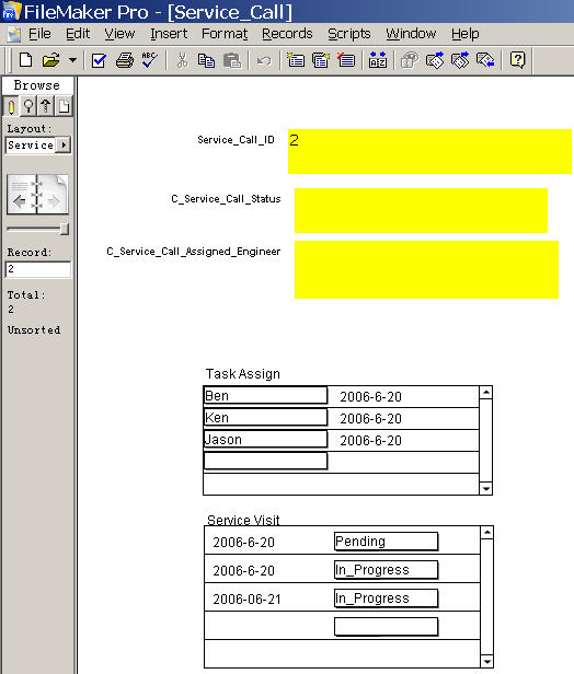

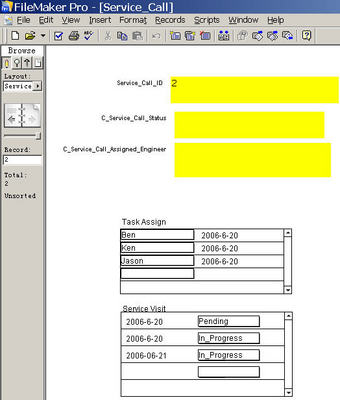

The Problem is:(in screenshot2)
How can I define the caculation to make Service_Call_Assigned_Enginners="Ben+Ken+Jason"? And Service_Call_Status="In_Progress"? (if there's a "Finished" status in "Children", the status of Service_Call will be "Finished", otherwise it's set to the latest status of the "Child".)
Screenshot 1/2 and sample file are attached.

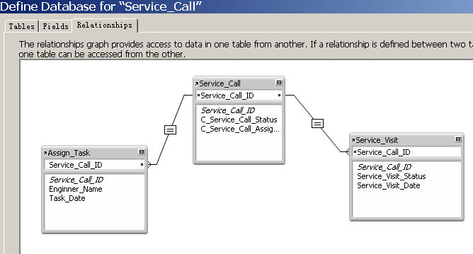

If your Engineer names can be in alphabetical order then you can use a value list.
For the status field you pretty much spelled it out. You need to define a field in Service_Call that = "Finished" and then link this to a new Table Occurrence of ServiceVisit where:
ServiceCall::ID_ServiceCall = ServiceVisit::id_ServiceCall
AND
ServiceCall::StatusFinished = ServiceVisit::Status
Example attached
Service_Call_Revised.zip
Thanks!
Your solution just open my mind.
