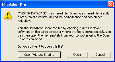

I think my issue is related to the one above.
I tried to set priviledges as well, but they weren't working like I anticipated. I've done the steps above, but I still get a dialog box upon opening FM.
How do I get rid of the dialog box (see attachment).
By doing what it says to do: open it where it resides, not over a network. You will end up damaging your file.
