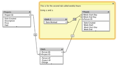

I've attached an updated version of the file. In "Form View - People", under the "Weekly Hours" tab, you'll see what I am trying to do. I want the portal to display all records from the given week, plus the total at the bottom. Would you be able to explain (for a novice) step-by-step what to do? Or, if it is not too much to ask, perhaps demonstrate?

Yes, this isn't a scripting matter at all, take a look above...so there would be no use for the buttons either.
Then did I notice redundance in similar fields named Expense Cost # these ought to be breaked out in related data as well.

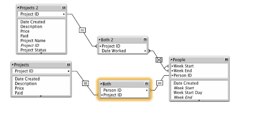

OK, thanks for that diagram... I've copied it into my file, but it's still not giving me the results I want. Now it seems to be showing the same record several times over in the portal (see attached). What am I missing?

Allright here you go!! What you should remember is that the portal should reflect the new relation, and dito goes with the fields ...and especially those tunneled from a yet a realtion away, look at the way I've changed your graph again!
Beyond that have I stuffed an autoenter (updating) feature into you choise of date, to prevent choises not mondays:
Week Start-Mod(5+DayOfWeek ( Week Start );7)
JobAccmod.zip
Yes! That's exactly what I was after. Thank you so much for you help, Søren!
