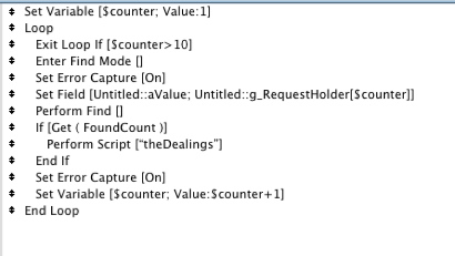

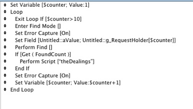

I'm not getting into the details of your post yet, but it seems like you should structure this series of searches this way:
First image is how to accomplish things under fm8

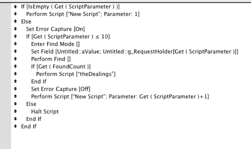

Next image is how to avoid using globals, recursive script!
Well I've just noticed that you're using FM7 so $variables are not yet availiable, but you could use a global number field where write "Set Variable" and change it to Set Field[ just remember to make it a global!!
A more crafty, but very unreadable method is to make a recursive script taking care of the counting:
