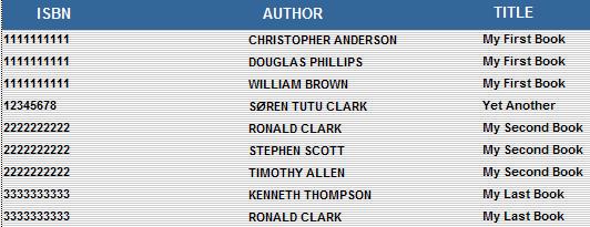

Hmm, I tried doing that and still didn't get the ouput I was looking for. I'm trying to get only one line for the whole book, not a header line for the book and then 3 lines below that for the authors.
I've included a couple pictures to show what I'm getting over here. Report_2 is the report after changing the report scipt to sort by ISBN first, then full_name. I also changed the sub-summaries so they summarize when sorted by ISBN. As you can see for each book we're using separate lines here which unfortuneatly won't work on some of our large reports. Report_Wish is what I'm trying to do.

Hmm, yea but it's not just about the breakers. Looking at the report above from your MOD2. We still have multiple lines for the same book: there's three lines for 'My First Book'. What I'm trying to do is have one line for the book and authors like the Report_Wish in my previous post.
I should mention that this isn't a new database I'm creating otherwise I could just do it the way you've shown here. I am rebuilding FM5 databases and people have been able do this in the past because we weren't using relationships: they just typed in the author name(s) in every time. I just know they are going to complain if their report that took one page now takes 3 because of the extra lines.

Ah! I didn't notice that - Authors in plural!!!!!
So this is next stab at it.
Books_to_AuthorMOD3.zip
There it is, exactly. Thanks so much Soren, you got it. I would never have thought of using the value list that way. I was stuck thinking about portals and how to use them like you used the value list.
