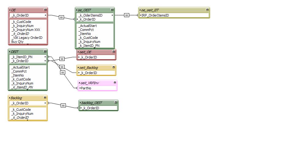

Sorry for the late response. I took a screenie of my TOG's. I'm running a basic backlog that is pulling Items from my Order Entry (OE) TO, and my Order Entry Items (OEIT) TO. My search function is find everything that has a value greater then 0 for the field QtyRemaining.

I agree. The structure is still not clear, and we still haven't heard where this Find is based, where the fields are based that it's searching, and what kind of fields are being searched. We guessed about an unstored calc being involved, but still haven't seen confirmation.

Here's the structure.
I'm performing my find on a Unstored, Calculated field called QtyRemainingTotal. I'm using a separate UI system to view the Data which has a relationship built from the OEIT (Order Entry Line Items table) to the OE (Order Entry Header Table). The QtyRemainingTotal sits in OEIT.
The Diagram I posted above is my Reporting UI file, which is nothing but TO's and contains 0 actual data. It's completely a UI system.
