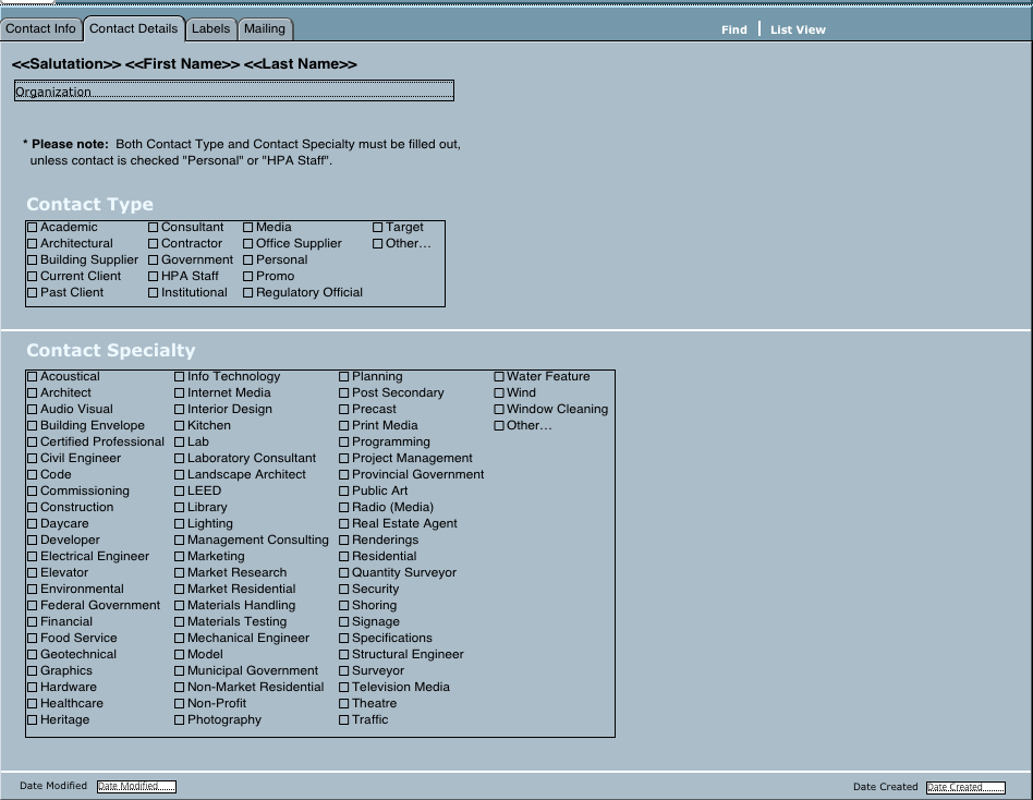

Thanks for getting back to me. I have one table, 4 tabs. The first tab has contact info on it - name, address, phone numbers, etc. We are an architectural firm so on the second tab I have the two checkbox sets - one for Contact Type - ie. client, personal, government, building supplier, etc. The second checkbox set is for more details on the client's specialty, ie. architect, code consultant, etc. I've attached a screen shot.
We had an old database in FM 3 which I've converted. So we will be editing old records and adding new. I'd like the message to come up before they move on. If the Contact Type is Personal or HPA staff, they don't need to fill out the Contact Specialty. I suppose it wouldn't be the end of the world if I can't make this happen.

Hi Noreen
While tabs are a great tool on this occasion I suggest that you use 2 different layouts instead of the tabs.
That way you can put a button on the first layout and attach a script to it which can first have a look at the two fields that you want to check and depending on the findings take the user to a relevant layout.
Hope that helps but if you need any more help get back to me
