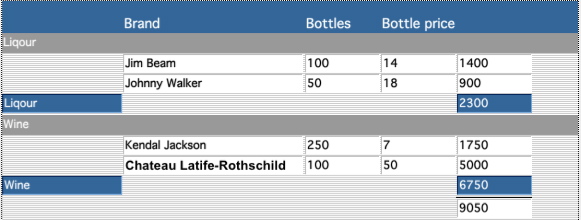

Do you mean something like the shown above??
Sort of, but not exactly.
