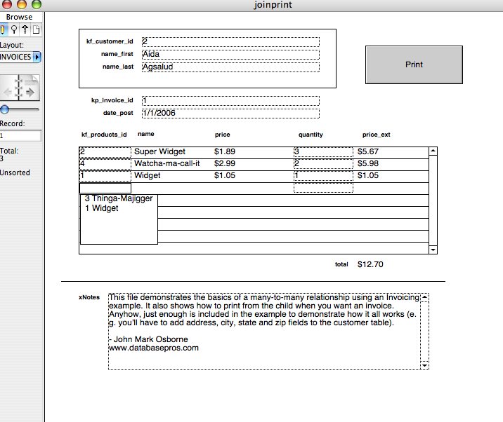

I looked at your files, but it doesn't seem to work. On the Invoice layout if I go to a new portal row and add another product, the popup menu doesn't update. I still see product id 1 (widget) in the menu after it is added to the current invoice.
I attached a screen shot.
I am using FM 8.5 Advanced.
I understand the general approach of gathering the product id's from the join table for the current invoice and using those with a not equal to relationship. It seems like the NotRelated Field isn't updating when a new portal row is added.
Did I miss something?

There is a relationship refresh issue that is easily corrected with the Refresh Window script step using the option to flush cached join results. Attach a button to the field with the popup menu using the steps in the attached screen shot.
