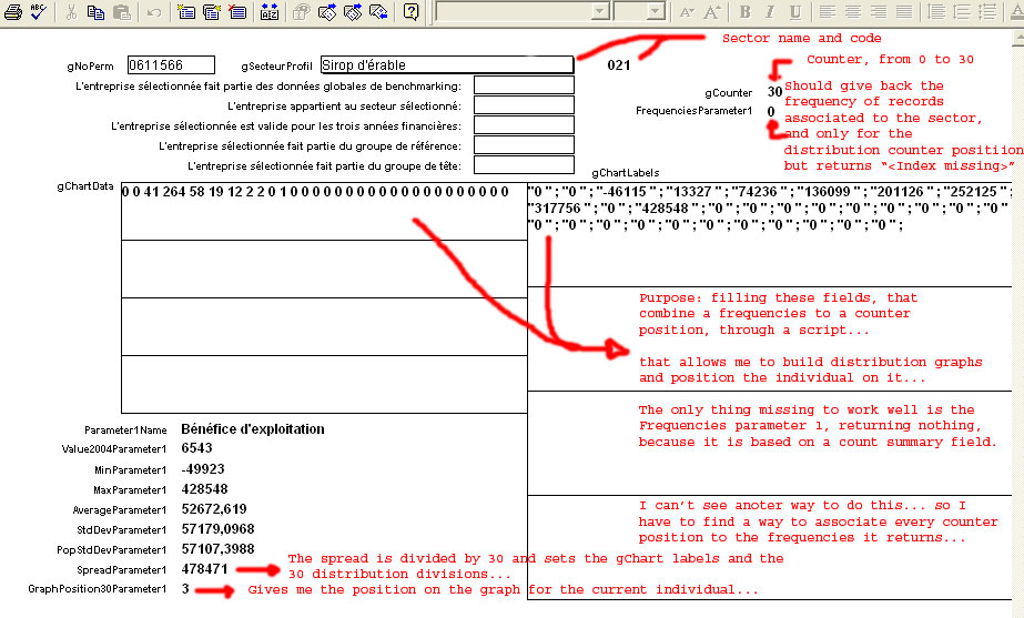

In the following example, I can easily get aggregate calculation results for the table occurence "DataReference2004", that indicate me stats about the records that match gSecteur... but I can't when I add a criteria in the relation that is based on a calculation field (GraphPosition30Parameter1) returning a number for each record and a global field (gCounter) in Viewer which contains integer numbers from 0 to 30

I try to get the results in a calculation field in the table Viewer that would get the count of the values for the sector and only for the ones that have the indicated position defined in gCounter, that is
= Count ( DataReference2004_Frequencies::Parameter1 )
Yet it works when I set it to
= Count ( DataReference2004::Parameter1 )
but then I get the results for all the sector, and not the count of the portion that goes in the sector AND appropriate position...
I checked, and there should be results that match both the criterias... so there should be a result
What's wrong?

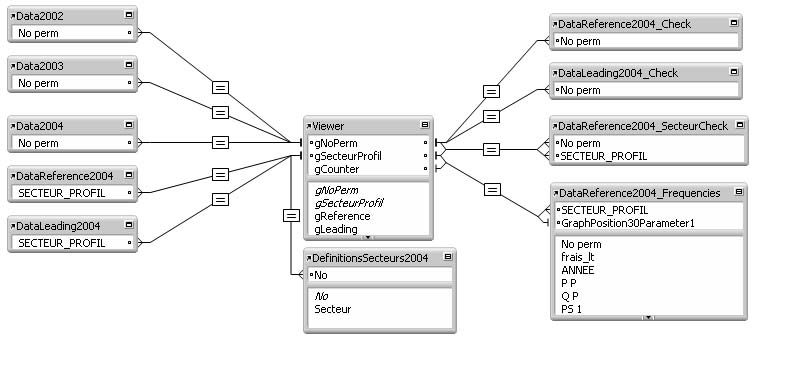

This must be here the flaw is:
and is unstored, and where
MinParameter1 is a calculation
...the third word "Unstored" and your graph confirms it, if you can't turn on indexing will the relation not work!
Ah! so the three little triangular lines indicate indexing, right? and when there is a vertical little bar on both occurences, the relation does not work... still right? it's good to know... i've been wondering for a while!

First do we need to establish as to why the secondary key won't index. My guess is that the calc' gets one or several values from a global field, or something a relation away, which pulls every thought of indexing down the drains.
I think that tinkering with more TO's in order to get alterations to the primary key instead, is worth persuing. This means the primary key is likely to be a calc'field instead, or something optained via a script.
I'm deliberately keeping my resonse a litle vague, because we were better of looking into a template or a clone of you system...
It is based on a summary field... of course it is not indexable, but I need to find a way to get the value!
Big deal... it's a frequency (count summary on certain conditions), I can't see how i can get it otherwise...
The database is pretty large, and contains confidential data, so all I can do is give you this other picture that should allow you to understand what I am trying to do. It is actually pretty simple. Then all you can do, I guess, is give me a feedback of your understanding, and some clues if you have any.
Alright it must come as a pleasant surprice that the breaker value in GetSummary( can manage unstored calc'fields values as well. I have made a food for thoughts template using Edoshins Fastsummary algorithm as well as the bidirectivity in relations.
I have in order to make the breaker values be pretty live based them on values a relation away, which must translate to something like your upper and lower boundaries for the graph creation. The portal sorts on the unstored field as well....
Hopefully can you follow the abstraction, and see how you can make 30 lines in a portal each recieving the frequency. Grapping specific lines is pretty easy with GetNthRecord( if you wish. Each line in the second portal is after the scripting each of the first occurences for each breaker value.
