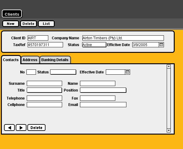

Thanks for the help. Here is an attached image of my current layout. As you can see I am already using tabs. I will be adding more buttons at the top where the other buttons are, for instance Courses, Jobs, Assesors ect. but I am not 100% sure of what buttons I am going to have yet, and I am planning to add other layouts later, but that will mean that if the main buttons change, I will need to go and change it on every single layout. Please please please tell me there is another way :)
