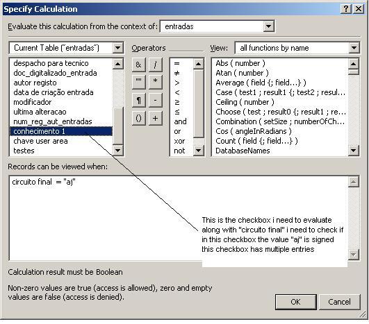

I'm using a database wich intends to serve as correspondance (mails letters etc) aplication.
It was incoming documentation and outgoing documentation. I've created a field in "incoming table" to validate the department where the original is going to, and created a [color:red]checkbox set with several entrances to sign all those departments who have cc of the incoming item, and should only view the record not edit it.
in privileges area i can give access easily to selected users to see the record where the their department is in the field wich has he original, but i cannot give access (view only or any other) to all the departments wich belong to the checkbox
can someone help

didn't resolve this problem i try to picture it for better help

the picture i sent shows the "privileges" area.
and it's before the login that i want this calculation to be done, to check if the checkbox as the "aj" value.
can i sustitute the (getprevileges) by a value like "aj"

You can't use equals; there's multiple values in the checkbox. Yes, you need to find out if it "has" the value. There's several ways to do that, Genx, mine, and others (Position()).
If you put this calculation in the Edit box of the Record access privileges it will happen, you don't need to worry about that.
